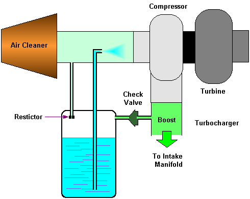

                  se isso funciona eu nao sei, mas olha só q legal carol:
                  alternatively, you can use a sealed fluid container, pressurized by boost pressure, to inject the fluid. the container must be capable of withstanding the boost your engine will produce. you have one boost line from the intake manifold to the top if the container to supply boost, and a fluid line from the bottom of the container to the compressor inlet to inject fluid. the boost line needs to have a one-way check valve installed so the engine vacuum is not applied to the container. again, a restrictor is necessary, and it is usually placed on a third ?ventá line.
                  in this case, larger restrictors mean less fluid is injected. this design has the advantage of no moving parts to fail, however it has the disadvantage of injecting the fluid before the intercooler, where there is a possibility it could condense on the inside, rather than flow smoothly to the manifold.
                  tirado daqui: http://www.megamanual.com/v22manual/mturbo.htm
